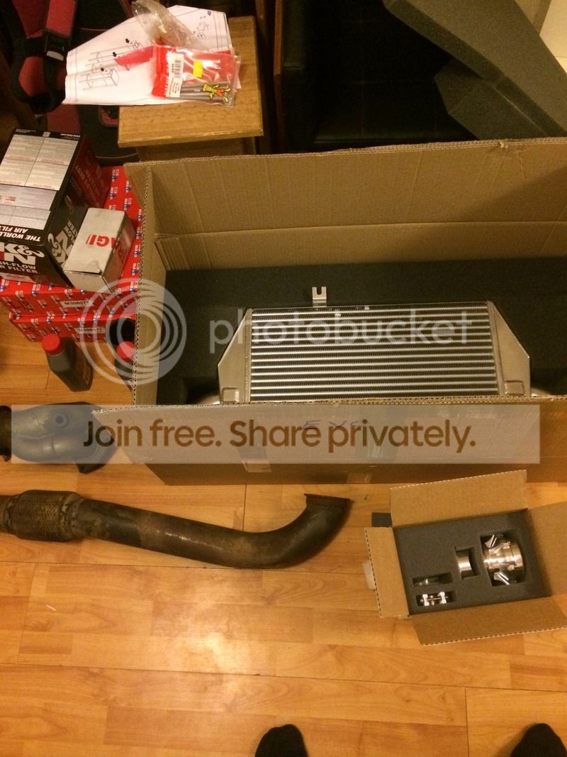

Earlier this week I went to visit Rossport for a chat with Ross and to get a few bits for the car. He is going to be supporting me and the car again for this year and I am very great full for his help!
Rossport rear discs
Giro disc pads
Tial BOV
3" air filter
Modular 3" downpipe
Rossport/pace intercooler

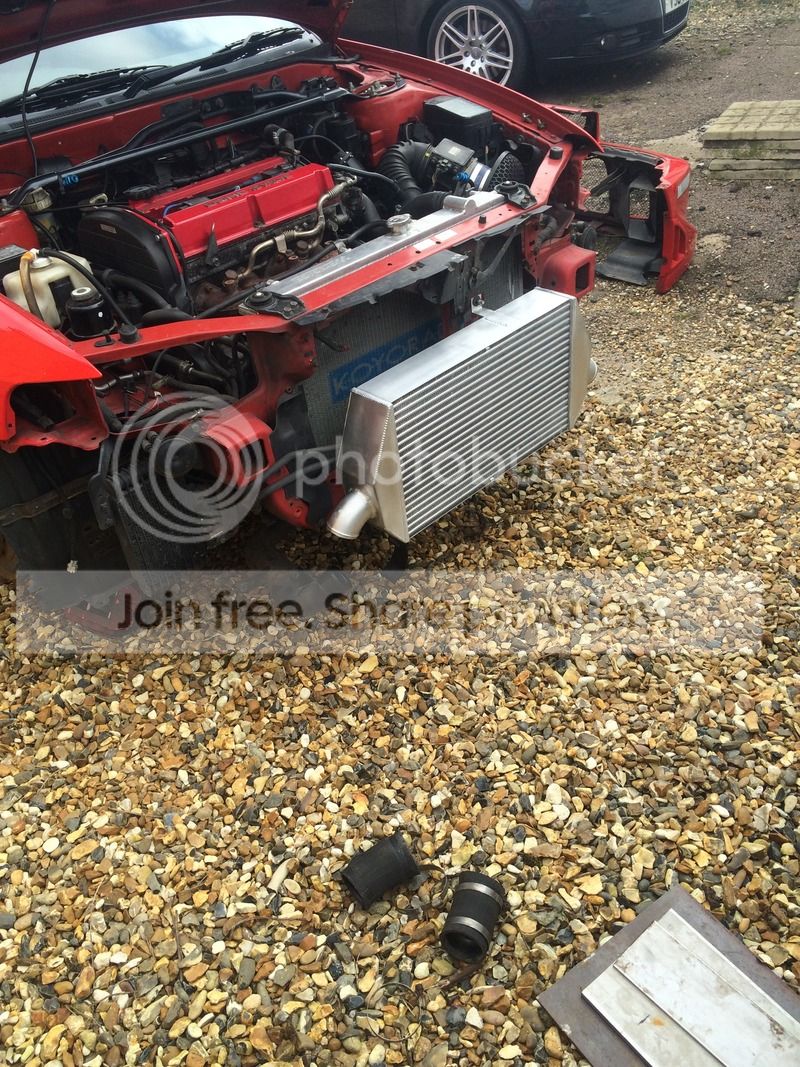

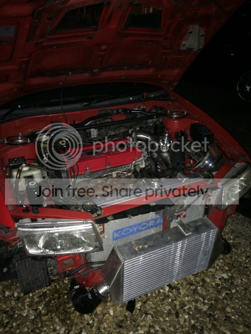

So with a little haul in the spare room, today I set about fitting a few bits and test fitting some other bits.
Hadn't realised this bugger was even bent, good job a decided to splash out on a new 1!
Trial fit. Now time to get my tape measure and angle finder out so I can start knocking up some pipes at work !

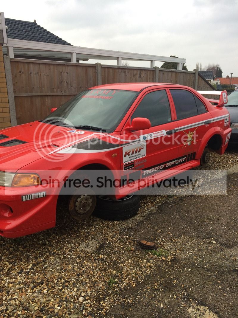

Made a little bit of progress over the weekend.
Managed to get the rear suspension all cleaned up etc then fitted the new rear brakes so the rear is moveable again.
And yes I know I need to referb my rear calipers but they work fine and as the race season is fast approaching I need to prioritise a bit.

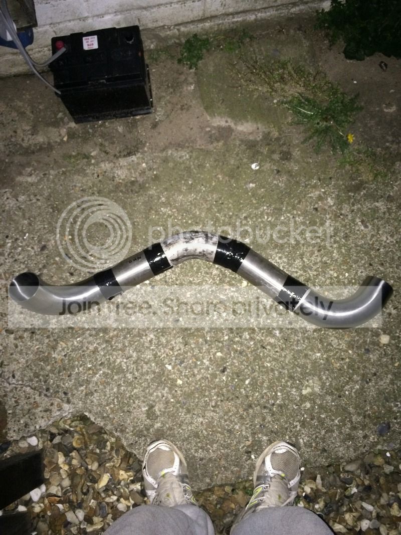

First off, the piping has been a bit of a pain. Only really due to not having the facilities at home to tack it in place and offer it up etc. here's how I managed to get around it.....
As tempting as it was to see how long duck tape (black and nasty) would last, I thought Id better weld them up at work. Please excuse the welding, I don't do much of it!
Here we have the cold/hot side IC piping and a new exhaust that will exit i front of the offside rear wheel and look towards the ground, as I'm fed up of having to worry about db tests and I might run a diffuser at some point.

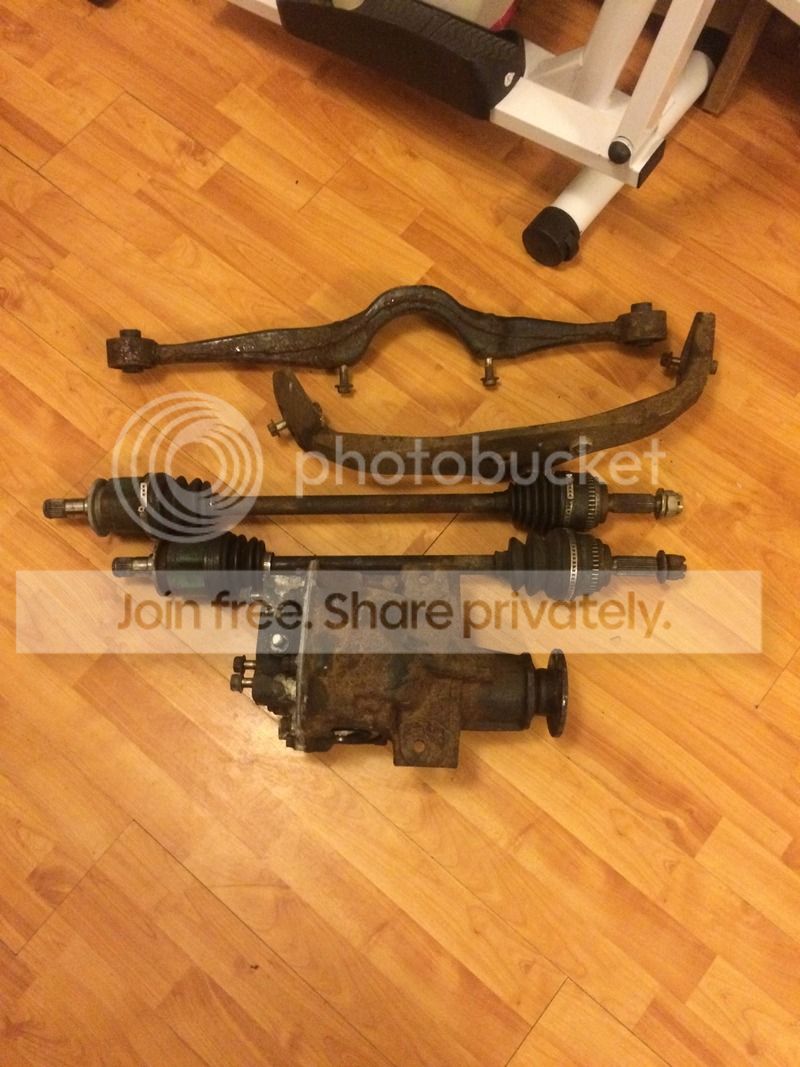

The keen eyed amount you may have noticed an rs diff set up
This will be fitted once the car is up and running again and I can get it over to a mates garage and up on a lift.

New stuff includes rs diff fitted and lexan windows.
