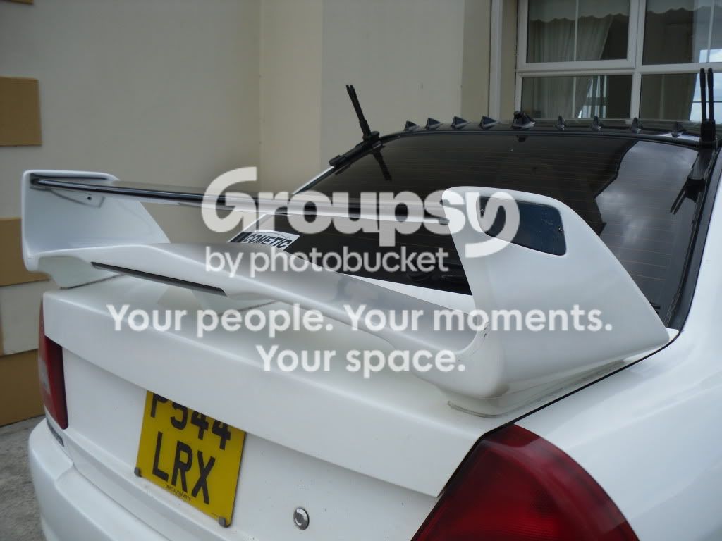

Looks tidy mate. The e5 spoiler makes such a difference to these. Personally i would put a standard front bumper back on and change wheel colour but thats personsl taste. Get some pics of the bits up mate and someone will be able to tell you whats on there.

Is it a 5 or 6 spoiler? I thought it was a 6.

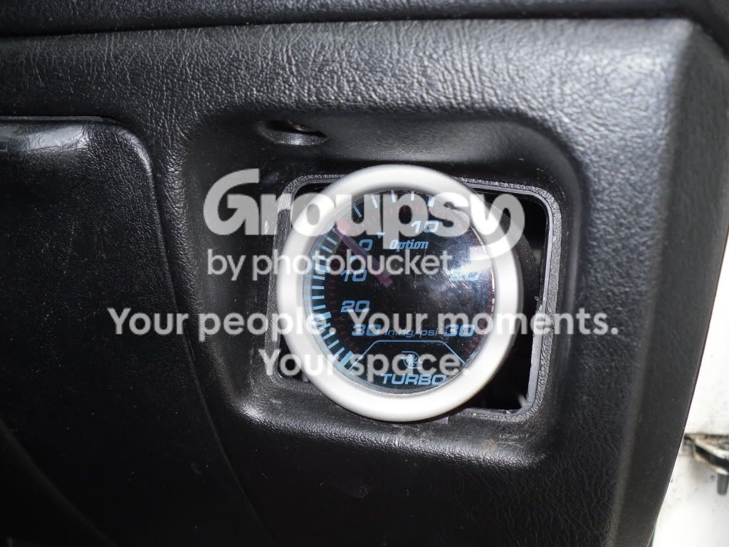

Here are some of the devices;

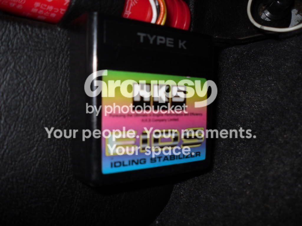

No idea what this does.
I know what this is but it doesn't appear to be working.

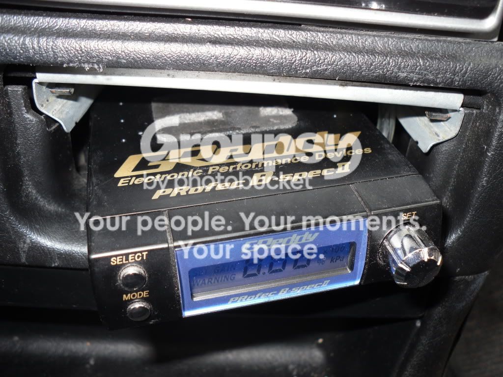

Not quite sure how to work this but the car boosts to 0.9 then dropping to 0.6 on [LO] but boosting fine to 0.95 when changed to [HI].

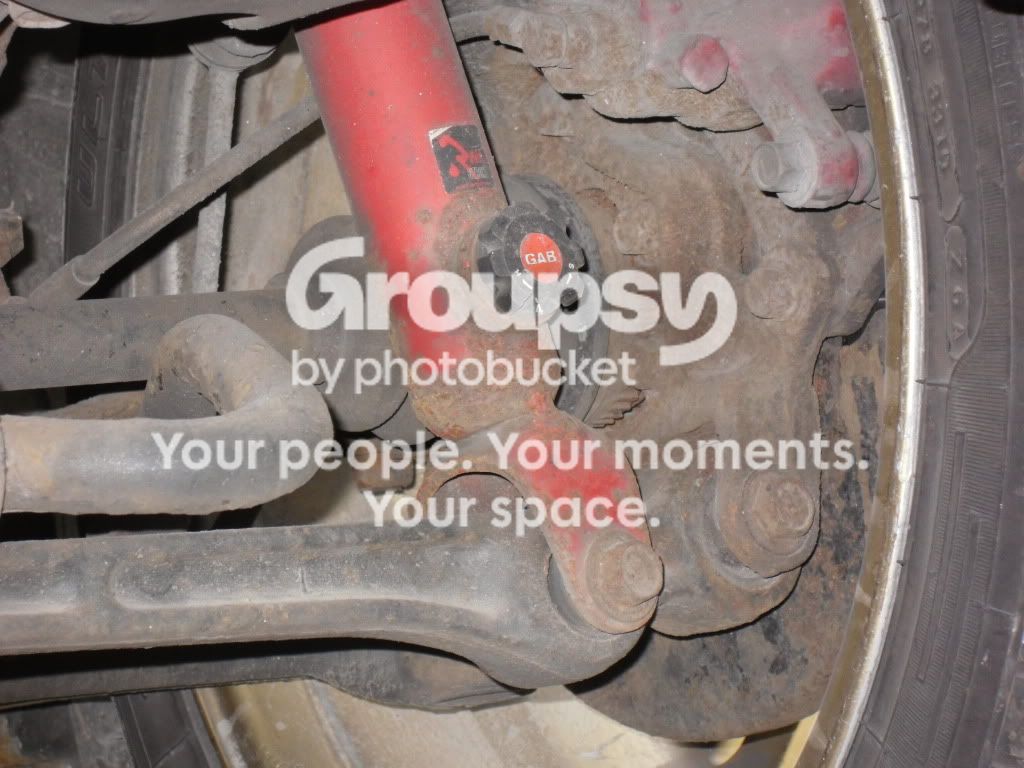

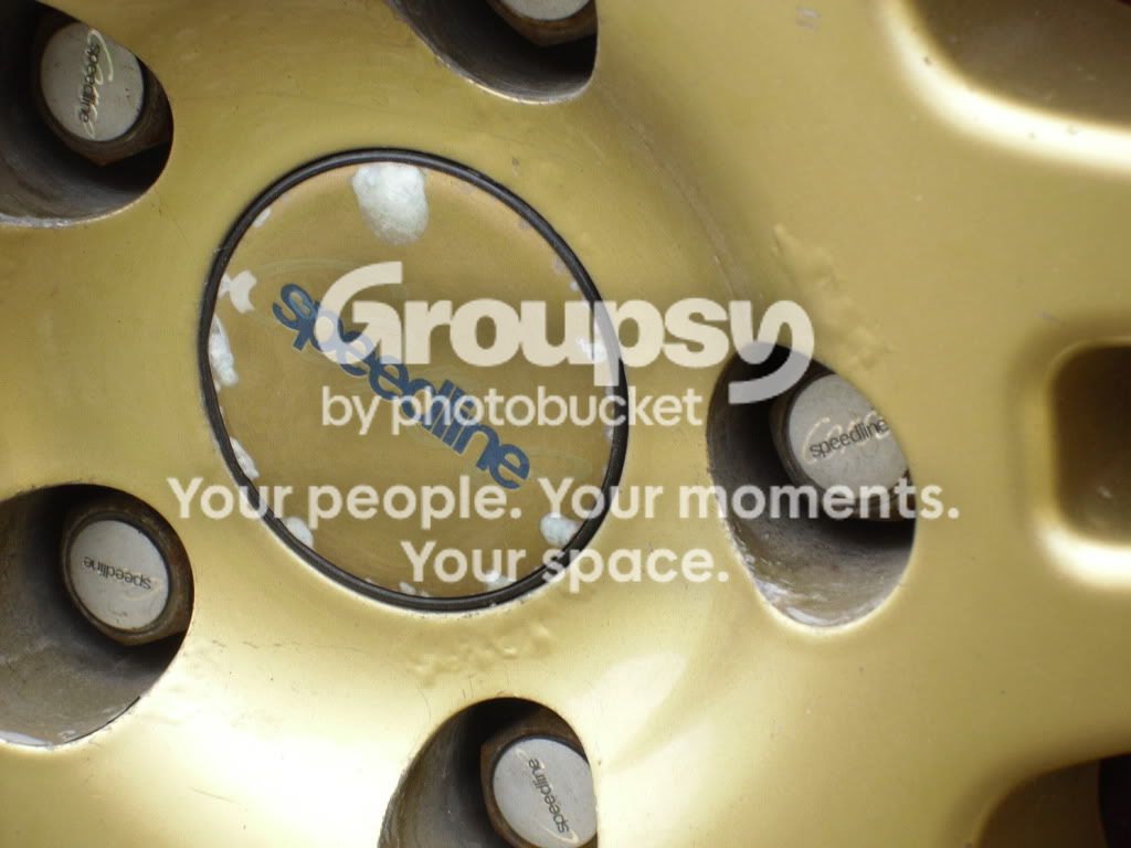

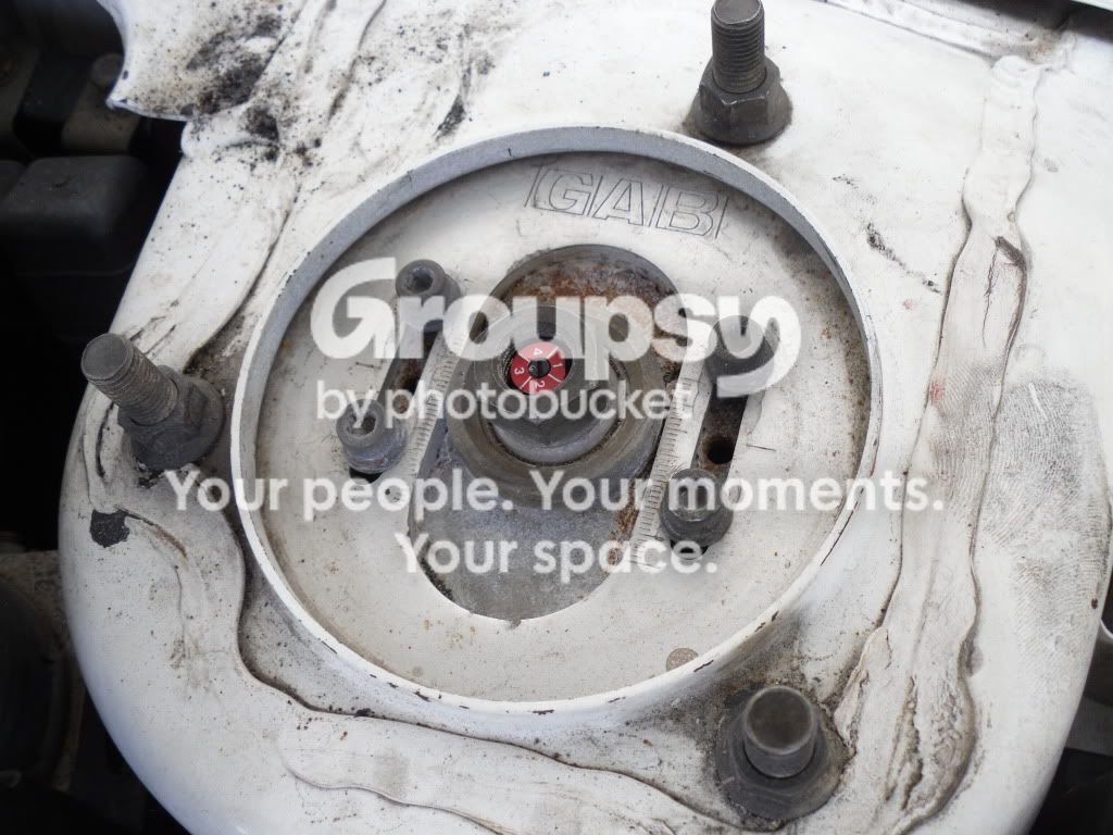

These need a good grease I would say to free them up.

the 6 rear spoiler is a very nice touch as is the front bumper imo :O)

I'm not so sure on the front bumper or the headlights myself. Thanks a lot for the info on the EIDS and controller!

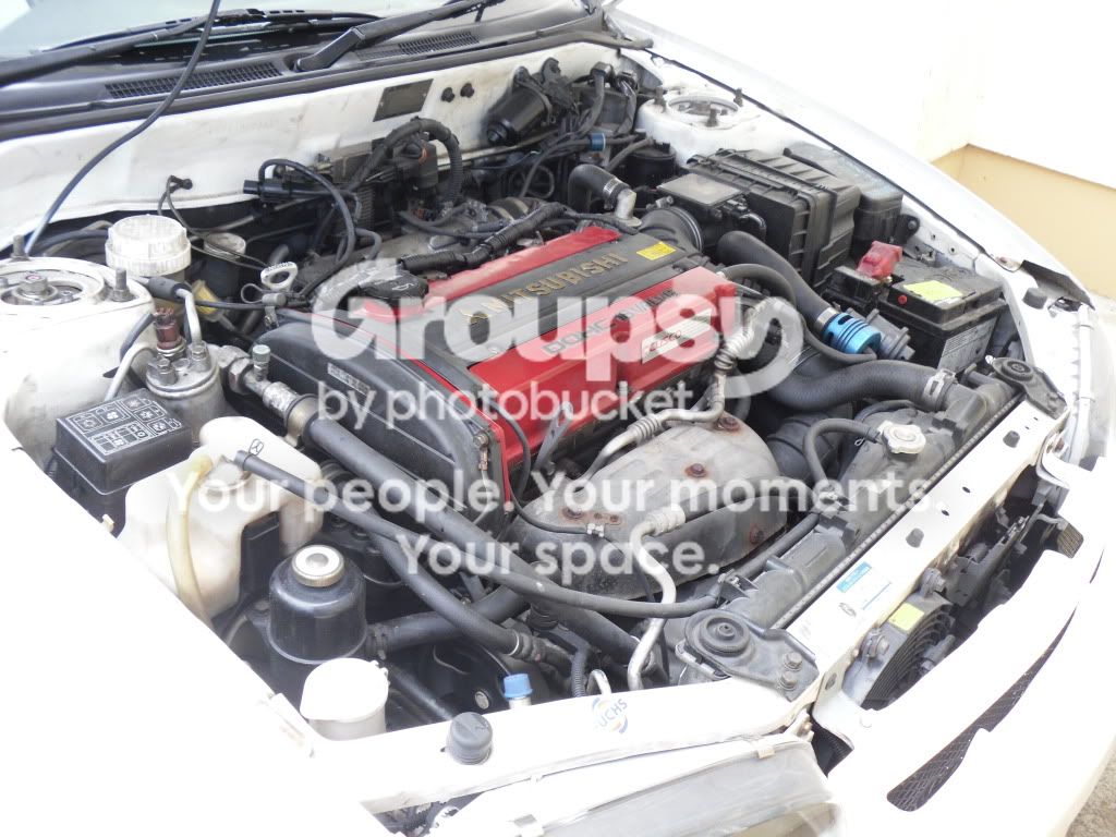

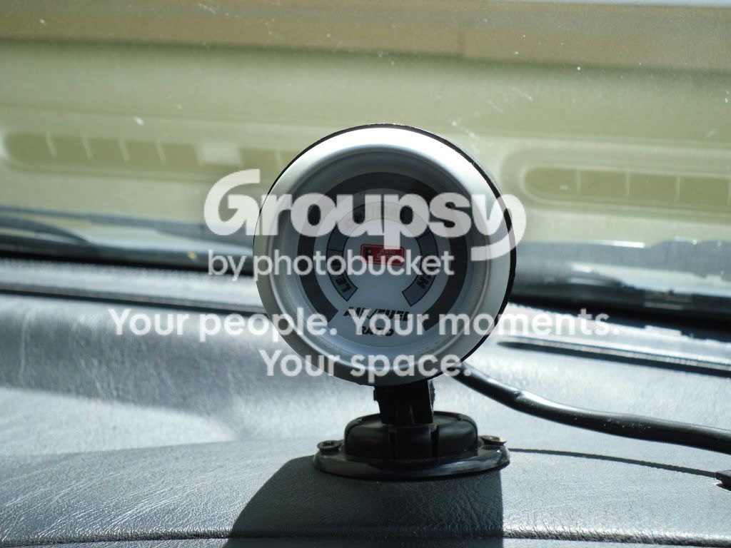

this looks like a cheap air fuel ratio gauge " narrow band " , that takes a signal from your 02 sensor , not that accurate to be honest ,wide band gauges are better :O)

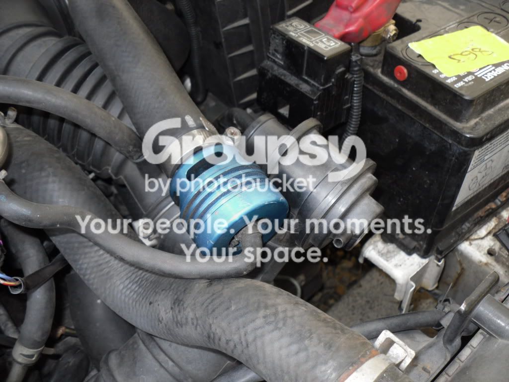

you have a atomspheric blow off valve " blue " sitting next to the standard recirculating one , dont know why the old one is still fitted ???

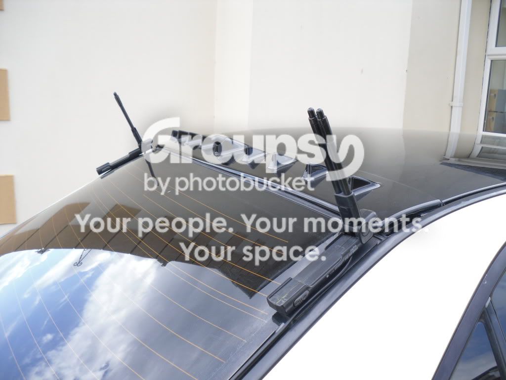

rear window mounted tv antenna "" i believe " think my mate has them on his evo ...:O)

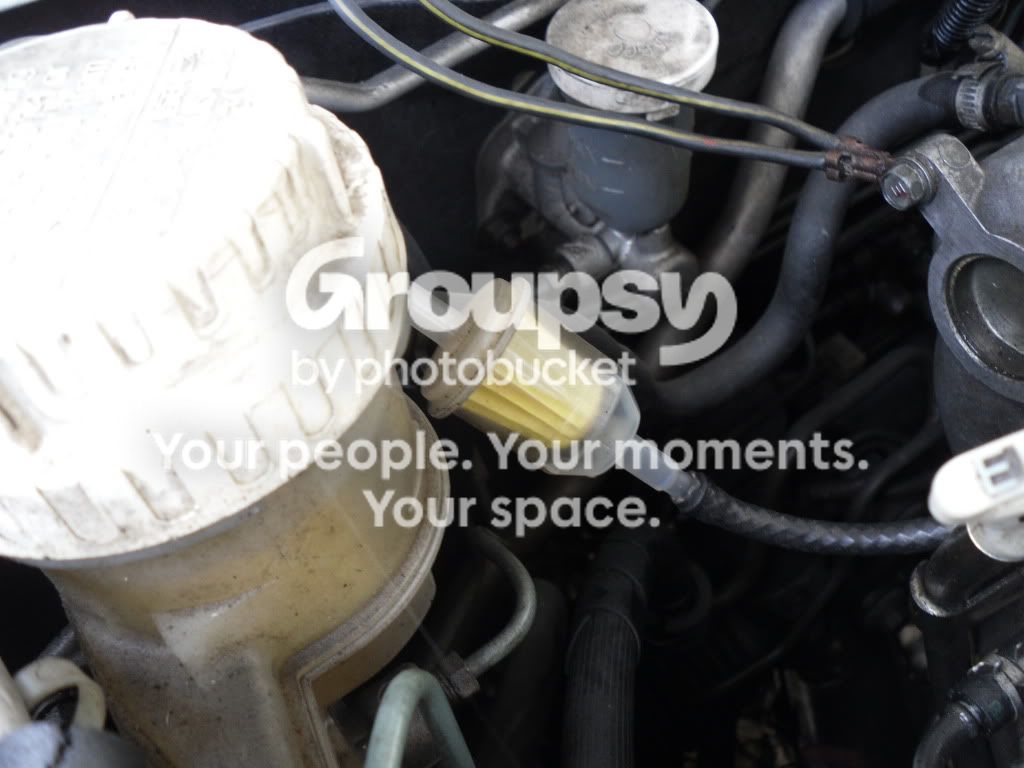

the small clear filter is ment for fuel but some are used on the pipe work for boost gauges or boost controllers as a air filters:O) follow the pipe work and see where it leads .

My mistake. Looked like a 5 spoiler in the first pic. Some nice toys fitted aswell by the look of it.
