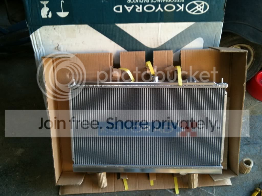

well after all the above was done its now time to bin my radiator in favour of a nice new koyrad and mitsi thermostat which was delivered today thanks to antony@indigo-gt :)
will add pics soon
will add pics soon
Told you I saw it when I was there Thursday:whistling:
Mmm hello :wub::):)

she was running a bit hot and my ecu has a engine coolant temp rev limit.
basicly the rpm limit was lowered to 3000rpm untill it cooled which explains why it was ok when i left track and went straight for slow drive down the road :)
hence the new rad and thermostat
